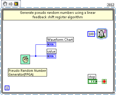

LabVIEW FPGA VI and example showing how to generate pseudo random numbers using a linear feedback shift register algorithm.
Description
The Pseudo Random Number Generator VI is built as an IP core for LV FPGA and can be used in a variety of applications. The VI is set to be reentrant so that it can be used multiple times in an application.The linear feedback shift register algorithm used to generate the pseudo random number is explained in detail in this Wikipedia article.

  1. Open "Pseudo Random Generator 2012 NIVerified.vi " and run it to show random values populating on the chart.
  2. Open the "Pseudo Random Number Generator (FPGA) 2012" to examine how this is accomplished.
To implement this on an FPGA target:
  1. Add the "Pseudo Random Number Generator (FPGA) 2012" and "Pseudo Random Generator 2012 NIVerified" VIs to your directory and/or project.
  2. Use the "Pseudo Random Generator 2012 NIVerified" as your FPGA VI, then compile and run this example interactively to notice the numbers populating
VI Snippet of Pseudo Random Generator 2012 NIVerified.vi
VI Snippet of Pseudo Random Number Generator (FPGA) 2012
