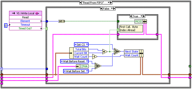

When a command has been received by the SPI engine on the FPGA, one cycle of communication begins. Each byte is read from a VI-Scoped FIFO with data passed from the multiplexer and stored as a boolean array on the FPGA.
Figure 1. Read data to transfer from FIFO.
After receiving the data to be sent to SPI bus, the chip select (CS) line designating the device to be written to is asserted. When the device’s chip select line is asserted, it becomes ready to receive and send data one bit at a time. Only one chip select line can be active at any point during execution. The CS lines are implemented as integers written to digital I/O ports on the FPGA hardware. Each CS port can address 8 individual slaves.
Figure 2. Set Chip Select.

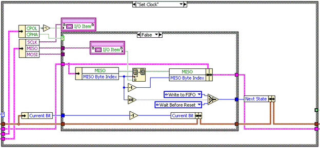

Each device will require a clock signal (SCLK) to be generated by the FPGA master. The rate of this clock may not be consistent for all devices on the port, so the clock rate can be set before each data transmission cycle. Once the chip select has been asserted, both the master and slave are ready for data transmission. The state machine transitions to a wait state and stays in this state long enough to account for the selected clock rate.
When the delay has completed, the first clock signal should be generated to begin data transfer. SPI devices can require one of four clock modes for transmission. These modes are dependent on the clock polarity (CPOL) and clock phase (CPHA). CPOL specifies whether the idle state of the clock is a logic low or logic high (0 or 1 respectively). CPHA designates whether data is clocked in/out on the first edge or second edge (0 or 1 respectively).
When the clock is set, it transitions from its idle state to the active state. If CPHA is 0, data is also clocked during this transition. If CPHA is 1, data is clocked when SCLK is reset from active to idle. Between setting and resetting the SCLK, another waiting state occurs to ensure the correct clock rate. These states are repeated in order for every bit that must be sent.
Figure 3. Set Clock

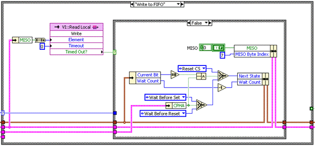

After each byte is transferred, the data received by the VI from the slave device is placed into another VI-Scoped FIFO for transfer back to the host. If all the data sent to the state machine has been sent, the chip select line is reset to the inactive state and the program waits for the next command. If the data is more than one byte, a transition back to the Set Clock state occurs and the rest of the data is transferred.
Figure 4. Write data received from slave to FIFO.
