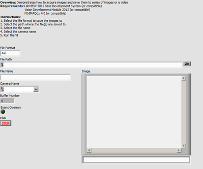

The example demonstrates how to acquire images and save them to series of images or a video.
Description
The example shows how to use an IMAQdx Get Image to save each frame as an individual image file (formats: BMP, JPG, PNG) or a video (format: AVI). In case the frames of the camera acquisition are saved in image files the file name is automatically incremented.

  1. Open the attached file
  2. Select the file format to save the images to
  3. Select the path where the file(s) are saved to
  4. Select the file name
  5. Select the camera name
  6. Run the VI
