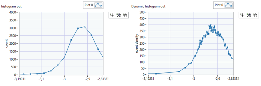

1. Arjan Wiskerke - Event density plots, a more dynamic alternative for histograms.
During evaluation of the results from our cytometer, we used the histograms LabVIEW library. Often, the data turns out to be located in a limited number of bins and only after tweaking the range and bin size parameters, the data is represented nicely. To overcome this problem, I devised a plot in which every point the same number of events and the bin size is different for each point. The value displayed on the y axes is than given by the number of events divided by the size of the bin. It turns out that this approach has great advantages in implementation efficiency and represents the data much better. Figure 1 shows data in the a traditional histogram where all bin sizes are equal, in figure 2, the same data is plotted as a event density plot where data point are closer to each other where the intensity is high and further apart in low intensity regions.
Figure 1 Data plotted in a “traditional” histogram, on the vertical axis is the number of counts in each bin.
Figure 2 Event density plot, each point represents the same number of events. On the vertical axes is the event density.
During my presentation I will elaborate on implementation and the advantages of this type of plot. Furthermore, I will discuss refinements that I implemented.
