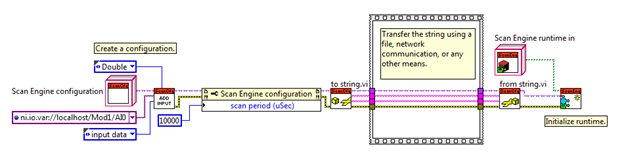

Each TBM Runtime class also has a TBM Configuration class paired with it. The configuration class allows developers to create an API that exposes different execution settings of the TBM runtime class, serializes and deserializes that information, and provide the final configuration to the TBM runtime ‘Initialize’ method where it is used to initialize the runtime class.
The configuration class is designed to support execution on any platform, while the runtime class implementation may be platform specific. Separating configuration information from execution code this way allows users to define system behavior on one platform (ex. Windows PC) without loading potentially incompatible runtime code as a dependency. That configuration information can then be converted to a string, and transferred to the intended TBM execution platform (ex. CompactRIO) where the runtime code gets loaded.
The image below shows an example of the Scan Engine TBM’s configuration class API. In addition to the parent methods provided by the CEF configuration class, this implementation added a new functions to add channels to the configuration and to modify the Scan Engine’s scan period. The ‘to string’ method then converts this information to a string for transport using a file, network communication, or other means. This information can then be delivered to the ‘from string’ method where it is converted back into the configuration class object and provided as an input to the Scan Engine runtime ‘Init’ function.

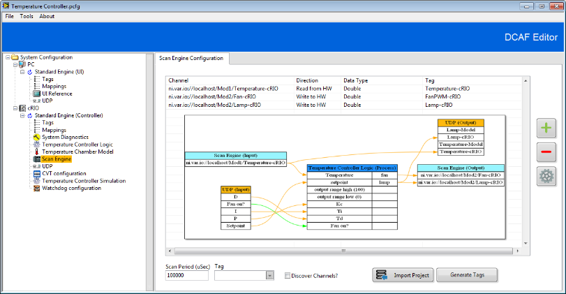

DCAF Tag Editor Core
The concept of an engine allows users to develop applications by defining a collection of TBMs to call and by defining how those TBMs exchange data. Programmatically configuring all of this information using the TBM and Engine Execution Interface configuration APIs is possible, but unwieldy. Tag Editor Core provides a CEF-based user interface to abstract away the low-level details of the engine and TBM configuration APIs, making it easier to create, update, visualize, and maintain an application’s configurations.
Tag Editor Core integrates the engine and module frameworks with the CEF by defining a standard file format and means of visualizing engine and module configuration data in the CEF. It also defines a configuration object hierarchy that can be used to add one or more targets to a system, add one or more execution engines to a target, and add one or more TBMs to an engine. Below is an example of a configuration editor built using the tools provided by Tag Editor Core.
Tag Editor Core defines a repository, a file format, a target, a system, and a new CEF Editor Node class for the creation of system, target, engine, and TBM views. For an engine or TBM to be compatible, it must include an implementation of the Editor Node class in addition to its configuration and runtime classes. However with this view, Engine and TBM execution behavior can be defined in an easy-to-use editor, saved to a file, reloaded for future modification, or transferred to a target for execution. Once on the target, a simple API can be used to identify which targets or engines to load. The image below demonstrates how this works.
Like the Engine Execution Interface and the TBM framework, Tag Editor Core only provides a set of rules and guidelines for creating a configuration editor. This means that users have the flexibility of reusing an editor across various projects, or creating a new editor tailored for a particular project.
