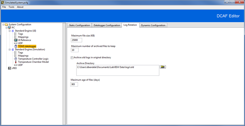

The TDMS Logging module implements a file management strategy using three user configurable rules:
1.    Generate a new log file when the current log is greater than or equal to Maximum file size (kB)
2.    Archive log files up to Maximum number of archived files to keep in a configurable directory.
3.    Delete log files with a last modified date older than Maximum age of files (days)
Note: Archived logs are rotated such that the newest log has the lowest index (for example, “MyLog.1.tdms” is newer (more recent) than “MyLog.2.tdms”).
Note: TDMS Logging module does not automatically archive existing log files. If a log file in the logging directory has the same name as the configured log file name, the existing file will be overwritten without warning.

Configure your data archival strategy in the ‘Log Rotation’ tab.

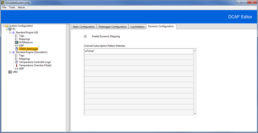

Dynamic mappings can also be configured to log tags with names that match patterns specified in the ‘Dynamic Configuration’ tab. Use the syntax of the LabVIEW Match Pattern function to find matching tags when the module initializes at runtime.
