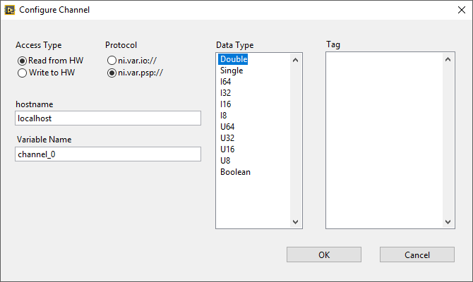

You can also manually add IO Variables using the ‘+’ button. You can delete channels using the ‘-‘ button. Use the gear button to edit a channel. When adding or editing a channel, the screen below will be presented:
Access Type: Whether the data will be coming into the DCAF module from Scan Engine (Read from HW) or out to Scan Engine from DCAF (Write to HW).
Protocol: Whether to use the Scan Engine IO Variable protocol (ni.var.io) or the NI Publish-Subscribe Protocol (ni.var.psp) for network published shared variables.
Hostname: The name of the host publishing the variable. For C Series Modules on the same CompactRIO that will be running DCAF, you can use localhost.
Variable Name: The name of the shared variable on the host.
Data Type: The type of data coming out of the shared variable.
Tag: The Tag you want to connect the channel to.
