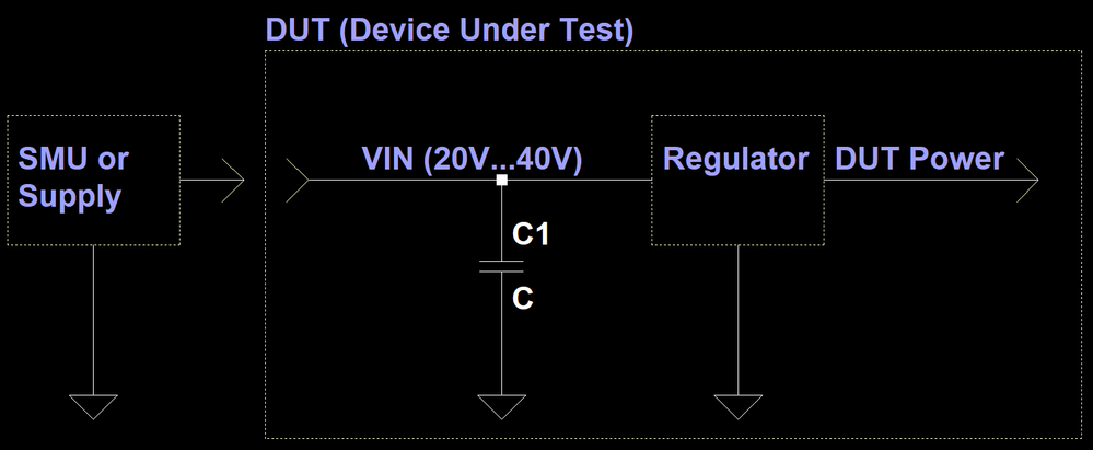

Hello, apologize in advance if this has been asked, I didn't see it.
This is a pre-sales question for an automated system intended to replace bench tests. The products being tested have a relatively large input capacitance (10mF...30mF) on the power input and relatively low steady-state current draw. There is little no current limiting series resistance, mainly limited by power supply foldback. In some cases power can be hard-switched on (e.g. via electromechanical relays / EMR or field-effect transistor / FET). In other words a delta T of perhaps 200us (200 microseconds) to 1ms (1,000 microseconds). The power being switched in may be 5V, 12V, or even as high as 30V. Using a basic I = C*dV/dt equation it's clear the theoretical inrush current blows up to an unrealistic number (because of course the source and path will have some resistance, the capacitors will have some ESR, etc.)
I = C * dV / dt
 = 0.03 F * 30 V / 200E-6 s
 = 4,500 Apk
Realistically, in some cases we have measured 20Apk to even 70Apk, which gives one an idea of how much foldback / equivalent series resistance is present in the system (I'll spare you that math 🙂 ).
The existing equipment we're attempting to replace for this (and other) measurements is a Tek scope with a hall effect current probe (model numbers aren't really important). We've found some clever ways to get around overloading the equipment, but essentially we need two different measurements:
  • one inrush measurement at fast sampling rates and low Amps/div setting on the scope, and
  • one long-term measurement at slow sampling rates and high Amps/div setting on the scope.
Going forward with automated equipment, I think it's reasonable we don't need to switch as hard (test equipment can reasonably limit inrush), but I need to have a comparative uncertainty analysis to be sure we can still test and reasonably detect an off-nominal input capacitance condition.
For example, knowing an inrush current is 10Apk for the system, should be fine. Let's say capacitor limits are +/-1%, we have 100x better basic accuracy within those limits using a 16-bit DAQ sampling at 1MS/s across a sense resistor. (No, we are not going to use an LCR meter for this application, I'll spare you the details.)
I am planning to have NI switches in the circuit to switch among multiple units under test, probably an EMR for this high inrush test, but I'd rather put the work on the supply or our own PMOS FET rather than wear out the EMR switch by hot-switching. As such, I'm not satisfied with the detail in the 4150 and 4139 specifications and I'm asking for additional info. For more background,
  • In the 4150 configuration an example of the system is something like PX6771950, and
  • In the 4139 configuration an example of the system is something like PX6772373 (see PXI Advisor.)

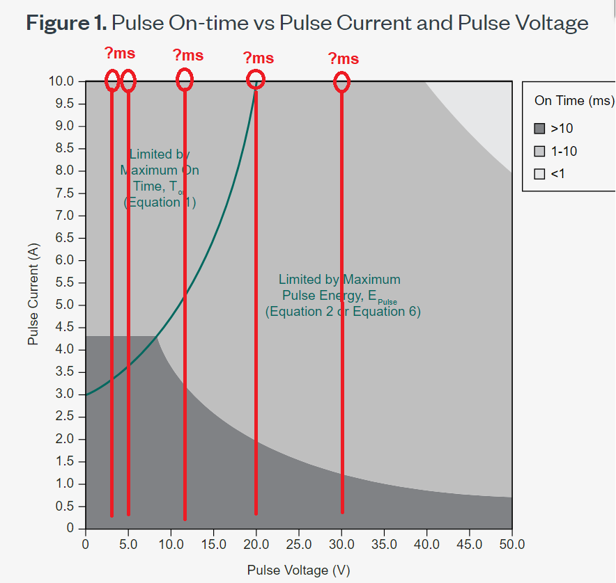

  4. Figure 1 of the specifications gives a fairly clear picture of what this instrument can do at 10A. It shows 10Apk for 1ms...10ms at 30V. Is there any way to exceed (in the driver) 10Apk for shorter (lets say 1ms) pulses?
  5. More a driver question than anything - see Figure 1 - is the 1ms...10ms driver limited somehow (e.g. will throw an error if exceeded) or is it just a hardware limitation that shows up without driver error? I'm pretty sure it's the later, because if it's the former, I don't know a method to avoid errors at 10Apk, various supply voltages, other than "guess and check" each pulse width.
    • If hardware as I suspect, could I get any characterization / finer granularity on pulse widths (e.g. short to ground) for these cases? See also image below, mark-up of Figure 1
      • 10Apk 3.3V output
      • 10Apk 5.0V output
      • 10Apk 12V output
      • 10Apk 20V output
      • 10Apk 30V output
  6. Same as 4150 question - are there any max load capacitance spec of the 4139? I see no notes.

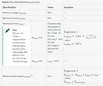

First, I'd like to make sure you realize there are two versions of the 4139: the original 20W version and a newer 40W version.  Their pulsing specs are different, and the pulsing graphs you pulled are for the 40W version.  The 20W version didn't merit a graph, I guess, since its specs are pretty straightforward.  Let's start with that one.
That 0.2 J energy spec is the one you need.  It tells you how much energy you can get from a single pulse.  So taking your 20V example, 20V x 10A = 200W.  0.2J / 200W = 1 msec.  Similar math for all the other voltages.
The "maximum cycle average power" spec is stating that if you're pulsing 200W, the downtime after your pulse has to be long enough to keep the average output power to 10 W.  If the output power during the off time is 0, that means you'll have to wait 19 times as long after the pulse as the pulse was on.  e.g. 1 msec on, 19 msec off.  The "maximum duty cycle" spec means that 5% is the maximum allowed duty cycle for an extended-range pulse even when the power levels are lower.
If you're not familiar with how pulsing is specified in NI-DCPower, I suggest you take a look at https://www.ni.com/docs/en-US/bundle/ni-dcpower/page/pulsing.html, which might clarify some terminology.  One thing that might not be obvious is that an SMU can do pulsing without using the "pulsing" API as long as the requested levels and limits fit within the DC power capabilities of the device.  The pulsing API is primarily to get access to pulsing beyond the DC limits.
The specs also contain the information you requested for the 40W 4139.  Look for the piece of the specs that starts like this:
I won't try to work through the equations here, but I think you should be able to figure them out.

"That 0.2 J energy spec is the one you need." (or 0.4 J for 40W)
I did see that math and ran the numbers, but nevertheless I was hoping for a graph with more detail for the 10Apk case at the voltages I provided simply to say "hey, here's an official NI graph that shows us what we'll get."
Also, I asked about the more precise pulse times because I saw this note in the spec and I wasn't able to find the article it refers to. Maybe it's deprecated? Maybe it was renamed to the "pulsing" article you pointed me to ?

Sorry if I'm somehow making this sound more complicated than it is. Here's an LTSPICE drawing of a basic system that operates this way. There is a large input capacitance, however the device doesn't turn on until over 20V is applied.
Existing tests supply >20V with a huge inrush current (>20Apk...70Apk) but with a very low steady-state current (100mA)
My proposal with the SMU is to break apart the tests. First, characterize the capacitance with a known current pulse, which won't exceed 20V and therefore won't turn on the device. Second, use a 3A DC (smaller) current source to turn on the device (>20V) and continue functional testing.

4. Not Answered Figure 1 of the specifications gives a fairly clear picture of what this instrument can do at 10A. It shows 10Apk for 1ms...10ms at 30V. Is there any way to exceed (in the driver) 10Apk for shorter (lets say 1ms) pulses?
I think this answer here is "no" just looking for confirmation, maybe you have already.
5. Pending More a driver question than anything - see Figure 1 - is the 1ms...10ms driver limited somehow (e.g. will throw an error if exceeded) or is it just a hardware limitation that shows up without driver error?
This is the most recent question we've discussed, and I think there's a missing reference in the specification. I have an answer for whether I get an error if I exceed the equations or if it's just a hardware limitation.
Seems like right now this still stands where #2 stands, it's a risk until we get IT approval, install software, and see what the driver does to a simulated device.

i.  Regarding graphs with more detail, sorry.  The graphs that are there are just to give a rough idea of what's possible, with the intention that a little math is required if you want more detail.
ii.  "Pulse On-Time vs Pulse Current and Pulse Voltage" is in fact the title of the very graph that you wish had more detail.  It's not an article.  It's supposed to give a quick idea of the range of values to expect, and which equation in the spec to focus on first.

5. The driver will limit your extended range pulse according to the equations in the specs.

"5. The driver will limit your extended range pulse according to the equations in the specs."
Ah, ok. I thought this may be the case... so those spec equations are hard-coded into the driver somewhere to throw an error if exceeded. It helps to know that because of how I need to plan for catching / handling errors.

In case anyone else wants a graph like I described with more resolution than Figure 1 from the specifications offers, here you go. I tried to cobble together something that looks similar to what NI's Figure 1 by bolding the numbers that define the <=1ms and >=10ms lines on Figure 1 from the specifications. Disclaimer: Obviously, this is not from NI.
If you want the 0.2 J (20W) numbers just change this cell A2 from 0.4 to 0.2

I noticed that your very nice shaded table doesn't highlight that in-range pulsing is of unlimited duration.  I'm terrible at Excel, but I had a crack at fixing that, as well as creating a simple table for the 20W board, which has not only half the available out-of-range pulsing energy, but also a fixed 1msec maximum out-of-range pulse time.  In the following tables, I arbitrarily assigned a value of 999 msec to the in-range region, but of course there's no limit, since those VxI combinations are within the DC limits of the device.
And I rather sheepishly attach my hacked version of your spreadsheet below.
