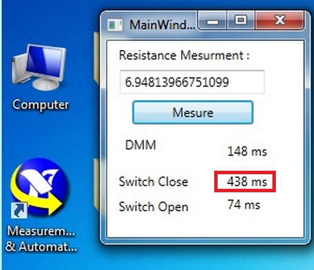

in first place if we want to open a session to Switch it take about 0.4s :
the reason why i do not initialize the switch only once, is because i have 13 switch to control, and target relay could be at any switch, so in order to close a relay i must identify the switch name + relay name :
I don't understand if you mean that the first time you open a NI-SWITCH session it takes 0.4 s, or if you mean that everytime you open an NI-SWITCH session it takes 0.4 s. This seems like an excessive amount of time but I don't know what system you are running this on.
You should still initialize the session to each switch only once, and then reuse the open session, rather than open and close every time.
As far as other performance improvements, maybe do a little bit more benchmarking and let us know where things are taking a long time.

I think there's a misunderstanding.
I'm telling you to open 13 separate sessions and keep them all open at the same time, not "a session with 13 switch in the same time". That means you will have 13 instances of type NISwitch, one for each device. Then you call RelayOperations.RelayControl on the correct instance based on which switch you need to act on.
