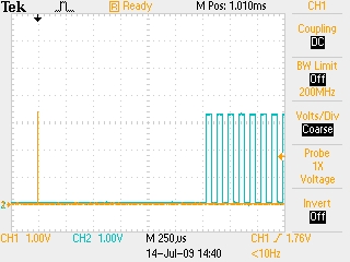

OK, I got a breakout box for the 68 pin output cable so I could actually watch the output from the DIO card.  I am still mystified why there is a 50 sample delay when I tell the card to output my waveform.  The waveform I'm generating is a simple square wave (bit 0 of a binary count).  I have attached two images that show the "problem".  The yellow waveform is the start trigger exported on PFI1, and the blue is the waveform.  The first image is the waveform run at 20 KHz, and the second is the same waveform run at 2Mhz.  Obviously it's not an electronic delay, it's something I'm doing wrong, but I'll be dipped if I can figure out what.

yellow is the start trigger for the generation?
A start trigger for generation is an asynchronous occurance.  It takes some analog time and a number of clock cycles to get sampled into the firmware, consumed by the state machines, and trigger the data stream.  We actually specify that time as "Delay from trigger to digital data output" on page 20 of the specs.  For the 655x its 32 sample clock cycles + 160ns.

OK, I understand.  I exported the data ready event on PFI2, and connected that to PFI3, which I then use as the start trigger for my dynamic read.  That cause the data to line up on a single card.
