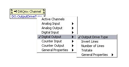

I think Buechsenschuetz is on the right track in suspecting that current drive may be your problem.  According to the USB-6501 Specifications document on page 9, the DIO lines are capable of sourcing only 0.6mA in Open-Collector (i.e. default) mode.  You can switch to Active-Drive (aka Push-Pull) mode via an NI-DAQmx Channel property.
In LabVIEW this is a channel property node as shown here:
For the C API the necessary function is "DAQmxSetDOOutputDriveType" as described in the NI-DAQmx C Reference Help (Start>>Programs>>National Instruments>>NI-DAQ).
Alternatively you can add an external pull-up resistor between the output pin and the +5V reference, but the aforementioned setting is recommended.
