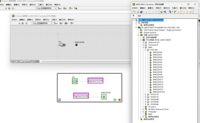

Hello! I am using sbRIO-9627 and trying to extend the Can bus and RS232 bus by using CLIP, but I have encountered a problem and have asked the details of the problem in the forum(How does the sbRIO-9627 extend more CAN buses and RS232 buses? - NI Community). I have since backed off and tried to extend the normal IOs using CLIP and designed a simple read/write experiment, hoping to use this to verify that my CLIP is working, and still encountered problems.

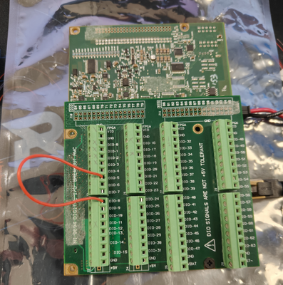

        First, the hardware connections are as follows:
        I connected DIO5 and DIO8 on the expansion card to verify the IO functionality by using DIO5 to write and DIO8 to read.
        I used two ways to do this:
                1. Direct RMC method, this method I successfully read and write, but this way seems to be unable to exemplify the CAN and serial port control core? (as below)

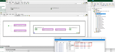

                2. CLIP method, read and write does not work, the following figure.
Through the first method to rule out the hardware problem, this experiment proved that indeed my CLIP configuration method has a problem. My configuration flow is in this post(How does the sbRIO-9627 extend more CAN buses and RS232 buses? - NI Community), please help me to see how to configure CLIP method? Extremely grateful!
