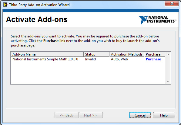

A LabVIEW library is a set of VIs that extends the functionality of the LabVIEW editor, also referred to as an add-on. To license a Library, we recommend using NILM unless your licensing needs are non-standard. If you are licensing a LabVIEW library with TPLAT, it is possible to require each development workstation to have a license for your library before LabVIEW will load your library in the editor. At start-up time, LabVIEW will display a list of licensed libraries along with their status, similar to the dialog below:

I'm creating an Add-on for LabVIEW within which I want to be able to host a number of licenses, namely:
1. Trial - 30-day unrestricted access (free)
2. Basic - 365 day restricted access (free)
3. Full - 365 day unrestricted access (paid)
These three licenses need to be possible options in one LabVIEW Add-on toolkit such that initially it installs with the 30-day trial (1) to allow a user to get to know the toolkit, then automatically drops into the restricted license (2) unless they decide to pay for further unrestricted access (3).
I've also been following the tutorial PDF document here for licensing a library and it demonstrates how to create a license file and attach it to a library, but I can't see how to create and attach more than one license? I have the three listed above, and there may be more to come, that all need to be attached to the library simultaneously. How does one go about achieving that? How can I implement the flexibility to provide one purchaser with a 30 day trial and another a 60 day trial and another a 90 day full license etc? Can all this be accommodated by the SOLO and ProtectionPlus systems?
Thoric (CLA, CLED, CTD and LabVIEW Champion)
vishots.com
Member
Member
on
You can only attach 1 license to a library. You should only need one. Options are configured within the one license file.
You can configure the default behaviour to be #1. Then how you control the other modes is with issuing different activation codes. The codes unlock the different modes. You can issue an activation code vis telephone or (user initiated) over the web.
