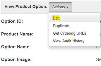

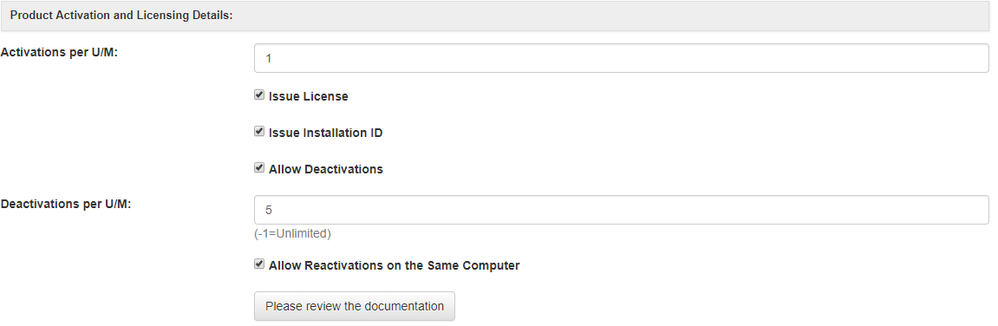

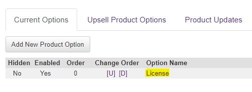

Part 2: Deactivate Add-on
After creating a license, a deactivation option can be added.
- Log in into your SOLO account and go to Configure>>>Products>>>Options and choose the product, which you want to have a deactivation.
- Scroll to the bottom of the page and click on the appropriate license.
- In the opened page choose Actions>> Edit from View Product Option:
Scroll to Product Activation and Licensing Details: section and check the Allow Deactivations check box for enabling deactivation option.
deactivation.PNGNote: Deactivations per U/M: allows to deactivate the add-on on the same machine exactly as many times as it is entered in the field. -1 allows unlimited deactivations.

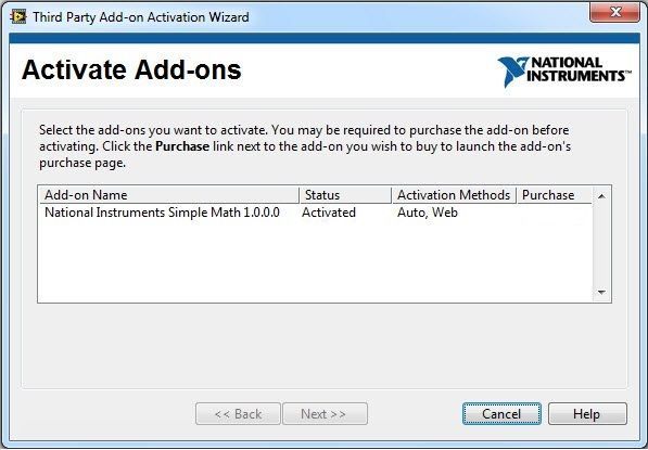

Part 3: Activate Add-on
Once a license is created for a customer, the last step is for them to activate the product with the license that they have purchased.
- In LabVIEW Choose Help > Activate Add-ons to open the Third Party Add-on Activation Wizard.
- Alternately, you can get to this from the Third Party Add-ons pop-up window when LabVIEW starts. Simply click Activate Add-ons to get to this window
- Click on the Add-on you want to activate and click “Next”.
- Ensure “Automatically activate through an Internet connection” is selected and click Next
- Note: if your computer does not have internet access, you can select “Use a Web browser on this or another computer to acquire an activation code” and follow the instructions on the following page.
- Enter the License ID and Password from the SOLO Server License details (see Part 1 Step 4) and click “Activate”.
- If the license ID and password was correct, the add-on will be successfully activated. Click Finish and restart LabVIEW in order to finalize the activation.
Part 4: Test Licensed Add-on
- Start LabVIEW. You will notice that no pop-up should occur on startup telling you have an unlicensed add-on.
- Choose Help > Activate Add-ons to open the Activation Wizard
- Note that the Status for the Simple Math Add-on should be “Activated”
- Open a new VI and place one of the licensed VIs on the block diagram. Notice how you can again program and run this VI like any other VI.
- Open the block diagram of the licensed VI. Notice that you can view the source code now that the VI is activated.
- Note: You can only view the block diagram of activated VIs that are not password protected. If you want to lock the block diagram of any VI, open the VI Properties and select the Protection category.

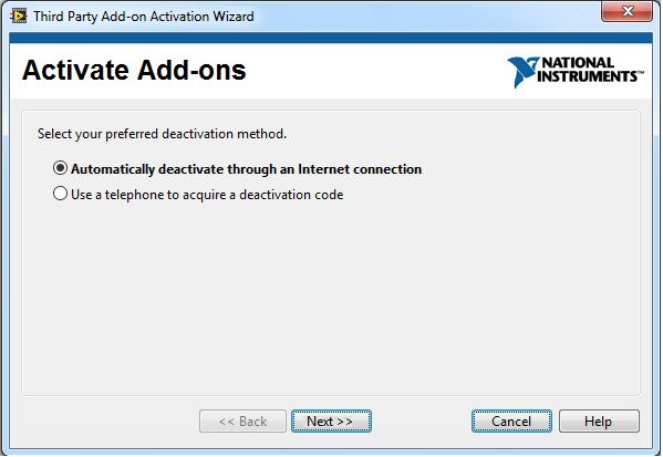

Part 4: Deactivate Add-on
The are some cases, when deactivation is required. For deactivating the add-on follow the steps below:
- Start LabVIEW.
- Go to Help > Activate Add-ons to open the Activation Wizard. Choose the add-on, that you like to deactivate and click Next.
- Choose the appropriate method for you to deactivate the add-on and click Next.
Untitled.png After successful implementation of these steps the add-on should be deactivated.
