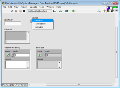

I think I would let module A start module C, as you describe.
And maybe let A broadcast C‘s event refs? If the message datatype was generic (we have a „System Message“ that all of our modules implement, for example), your other modules would only habe to register for A‘s broadcasts statically.

Thanks Joerg!
Could you explain your "System Message" a little bit more?  I'm not quite sure I understand what you mean.  Is this related to your method to dynamically load modules using wrappers for the common DQMH events?
Scott, we added a "generic" broadcast event to each module. As this event has the same name and datatype for every module, allows us to call it dynamically on each of our modules. This can be quite handy sometimes.
We don't need that generic broadcasting message for the Demo Application you referred to which loads/starts modules dynamically, but I made use of it in the Generic Networking Modules.
(Caveat: I'll be reworking these public code repos in the next weeks to add features and tidy them up a lot - hopefully)
