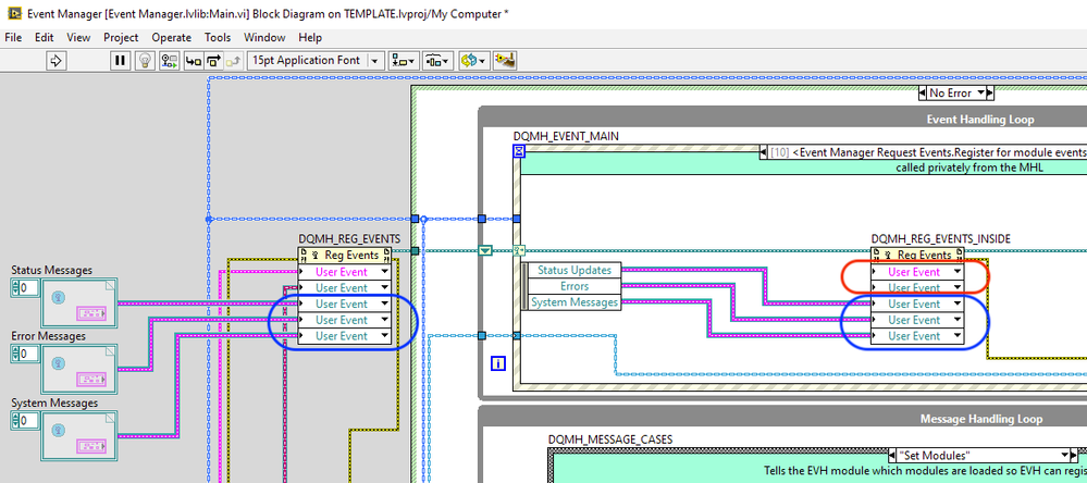

So I replaced the Start Module.vi/Synchronize Module Events.vi pair with Obtain Broadcast Events for Registration.vi (fig. 2), and then started adding the Start Module.vi/Synchronize Module Events.vi pair into individual event cases in the code, this is where I run into trouble.
Fig. 2Fig. 2
When I go to start the modules and register for their events dynamically from within the event structure it seems I have to register for all of them at once - the register for events function is not resizable (Fig. 3), it doesn't let me register for only one of the module's events at a time. What should I do in this case? Hold all of the broadcast events for registration in a shift register in the EHL? Is there a better (cleaner) way to dynamically start modules individually? Should I be using the 'Launcher' rather then the UI to launch these modules?

you can update single event registrations from inside the event structure. Just leave those event registrations unwired that you don't want to update. Seeing as you need to define the events (or rather, the case of the event structure) during edit time, you need to prepare all the events beforehand, for example with constants or via the "Obtain broadcast" VIs.
If you don't know the number of events (i.e. modules) upfront, you can supply an array of events. See our HSE Windows Application Template (UI Manager:Set Modules) for details.
See the screenshot...

Thanks Joerg, looks like it was a misunderstanding on my part.
I assumed all of the user events had to be wired in each case, I didn't realize I could just leave them unwired (I did a quick test on this and some of the modules events weren't firing but it must have been for a different reason!). I'll certainly check out the template.
You can leave the inputs unwired. If you look for a similar behavior elsewhere in LabVIEW, check the bundle function. The bundle by name requires all its inputs to be wired but the bundle doesn't. It assumes that whatever is in the middle terminal is the value that remains.
From the Bundle function help: "You also can use this function to change the values of individual elements in an existing cluster without having to specify new values for all elements."
When I teach people about registration of events, I like to show them the bundle, the majority of LabVIEW developers are familiar with the bundle function and it is an easier transition to understand why you don't have to wire all the events in the Register for Events function.
I hope this helps clarify and doesn't make it more confusing.
Regarding launching multiple modules, do take a look at Joerg's architecture, it is a good alternative to when you want to launch multiple DQMH modules.
