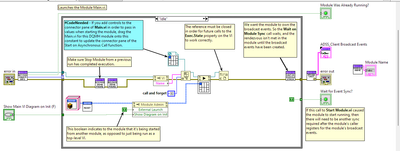

Start module causing error 1003
Very strange thing happening.  My application works flawlessly in development.
Ran module validation, VI analyzer.....no issues.
Problem is when I build the exe, then it doesn't run!
and of all things, it is the start module.
I checked and it's just the plain start module
Not sure if related but normally it will tell you which VI.  In this error msg, it doesn't say any.  Just shows call chain.
I've built EXE using 2021 and 2025, both has the same error.
Any idea where to look next?
