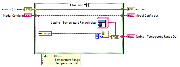

Read a Setting from a Config uses three steps: Since we want to wire this VI to FP-elements it returns native LabView Datatypes and has to be public.
Read SettingRead Setting
In the second step a private VI is used for reading the correct Setting Class of the Config.
Read Setting out of ConfigRead Setting out of Config

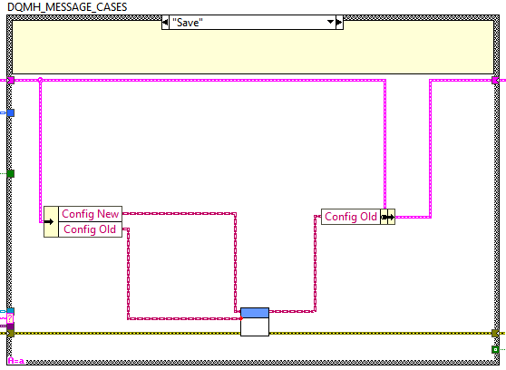

But when the user wants to save his changes, we must compare all settings in the two configs to make the corresponding requests to the settings editor. Therefore we call the abstract VI Check Changes And Request Config Change Setting. Abstract, because multiple GUIs could use different Config Modules, each of them implementing that method. So that case looks always the same, but the shift register of a different GUI would hold a different Config Class Implementation.
GUI SaveGUI Save

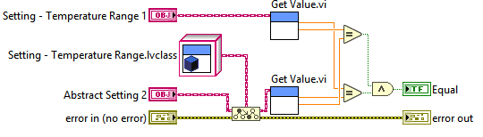

Lets look at the implementation of that VI of a concrete Module Config. For dynamic dispatch it has an input of its own class. The second input is an abstract class. That’s why we see a correction dot in the previous picture. But inside that concrete implementation we’re pretty shure that also the second Config must be of type Module Config so we can use To More Specific Class. From this point downwards I’ve not implemented error handling as you’ll see. That of course has to be done.Check Changes And Request Config Change SettingCheck Changes And Request Config Change Setting
So what has to happen is easy: If the new and old Setting have the same values (are equal), nothing must happen. But if changes have been made, we want to request the Config Module to set that particular setting to its new value. So we call the two abstract Vis isEqual and Request Config Change Setting. Now the magic of dynamic dispatch leads to the concrete implementation of these two Settings methods
Setting - is EqualSetting - is Equal
Setting - Request Config Change SettingSetting - Request Config Change Setting
