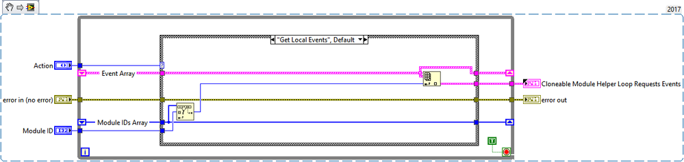

DQMH takes advantage of FGVs to pass around the references for the user events without seeing the wires. We went for this approach for clones too because we wanted to have the option of sending the same message exactly at the same time to all the clones.
Fab, thanks for your input about FGVs and AEs. Based on that and together with Jörg thoughts (I also have an ö) about wiring a refnum around I've now implemented the following new approach, which I've attached:
The uninitialized shiftregisters hold two arrays: One array with the refnums of the local events from all clones and one array with all module IDs of running clones.
AE - createAE - create
 When creating new events the new Module ID is added to an array. Both arrays have the same size  - grow and shrink simultaniously so the index from the Module IDs Array can be used to search the Event Array.
AE - getAE - get
This is used in the get case to retrieve the events of a specific clone.
AE - destroyAE - destroy
When a clone shuts down it passes it's Module ID in the Destroy Case which removes his entries from both arrays and destroys it's local events.
I've build a wrapper VI for each action (create, get, destroy) although it wasn't necessary, but it looks nicer.
Of course that way I still have to pass one extra information (now the Module ID instead of a refnum) in my start & stop helper VI, but I found myself alwas having the Module ID in the MHL in my hand in any case. BTW: I would always add the module id to the module data cluster and set it in the initialize case. This I could also add in an DQMH Template 🙂  Do you do it the same way? When using a broadcast in a cloneabel module I always would like to pass in the module ID anyway....
Do you see any problems with the way the Action Engine is working? Do I need error cases for not finding a Module ID in the array? I don't have an init case. We could use the First? Boolean from the Module Admin for that, but I don't know what should happen in that case. I expect the AE VI to leave memory when all clones has stopped, so it should be okay, shouldn't it? It would be bad if a clones breaks while running and the destroy wrapper is not used...

Thanks to the pointer to variant lookup tables. I've implemented that method instead of the one with two arrays. When it is a common technique and scales way better with large sets of name/value sets, why not use it 😉
Clone Registration.lvlib was interesting to look at how in DQMH a variant lookup table is build for the clonables module ids. I think you would use two separate AEs: "Clone Registration AE.vi" is responsable for the module IDs and "Local Events AE.vi" is responsable for the events associated with one specific clone.
So in "Init Module.vi" I would call "Create Local Events Requests" and in "Close Module.vi" call "Destroy Local Requests Events". Both use "Local Events AE.vi" with the module ids as an input. In "Init Module" use the "is first" boolean to init the variant lookup table if necessary. While closing the module there's no need to wait for the first, since the local events are separate for each clonable.
It would be nice if "Obtain Request Events.vi" would additionally generate the local Events and somehow bundle them together. But I don't invest more time here right now, since its getting too far and the main problem is already solved.

Yeah, but what's the point?   Fab's design of a local User Event could be a scripted option added to the DQMH.  It has no disadvantages to your design and several advantages.

@FabiolaDelaCueva wrote:
@AlexElb wrote:
first of all thank Delacor for offering the DQMH Framework. I started developing with Labview half a year ago and found your framework two months ago. Until now it works like a charm and I'm very happy with it. From time to time I found myself wondering how things work out, but mostly I found something online, e.g. joergs blogpost about helper loops which helped me a lot. Now to my question.
Hi Alex,
Glad to know that DQMH is working out for you.
@AlexElb wrote:
Now what I would do is to add the moduleID in the private requests. In the helper loop  I would then create a case structure and use the Addressed to This Module.vi like it is used in the EHL. But wouldn't it be much nicer, if the event in clone B doesn't get fired at all, when clone A is doing something?
If using the Addressed to This Module.vi is not enough for your case, meaning you are waking up and putting to sleep the helper loop events at different times and your code cannot cope with the disruption, then you can create a local event then. Instead of relying on the Private wake-up helper loop and set to sleep helper loop, create a local pair of events. To do this, you can create your events directly in the DQMH Main.vi. The picture below shows the creation of the local helper loop events, the MHL firing the Wake up Helper Loop.vi and the destruction of the local events outside the event handler loop. Note that you have to pass along the user event references because these events only exist in this block diagram.
The code inside the Create Local Request Events.vi, Destroy Local Request Events.vi and Wake up Helper Loop.vi is in the image below together with how I would structure the code inside the cloneable module library.Local Cloneable Module Events implementation.jpg
I hope this helps.
