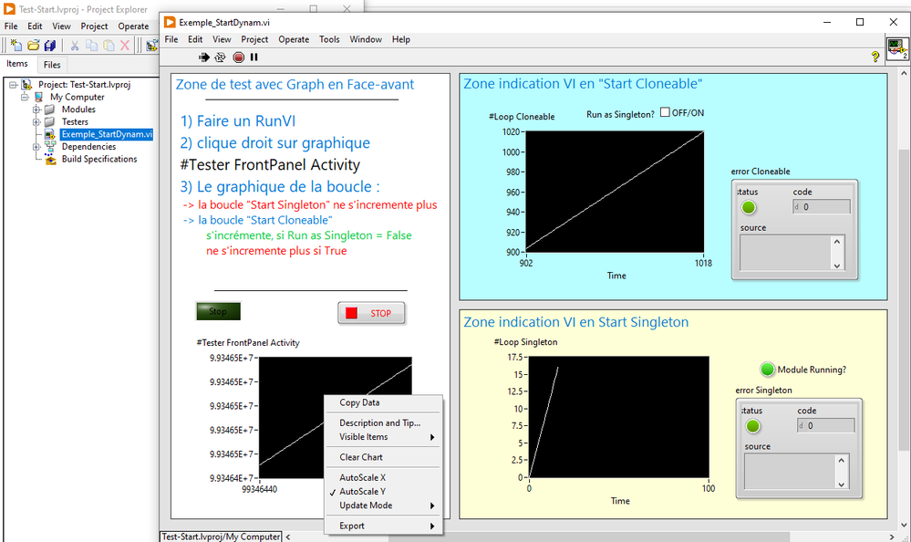

My problem : My program hang with "start module.vi". I would like to have your opinion.
I have singleton modules, which I start in my program, when the user performs actions under front panel IHM.
The modules are singleton mode. The user can right-click on front panel objects, run-time menu for example (run-time shortcut menu). We have detected that the "start module" vi can hang if a run-time menu is open.
I writed an example. cf Example_StartDynam.vi in ​​the PJ folder

Les modules sont en singleton. L'utilisateur a des graphiques, des objets .net, et autres. Il peut faire des clics droit sur les objets, afin d'ouvrir des menus (run-time shortcut menu). Nous avons détecté que le vi "start module" peut être bloqué si un run-time menu est ouvert.
Le vi n'est pas bloqué en cloneable.
J'ai réalisé un code exemple. cf Exemple_StartDynam.vi dans le dossier en PJ

The behaviour you are experiencing is expected. Indeed, the Open VI Ref node requires access to the Root Loop to be executed. That's why starting a singleton module (or a clonable with the start as singleton option enabled) is blocked by an opened menu in the UI. There is no possible fix for that.

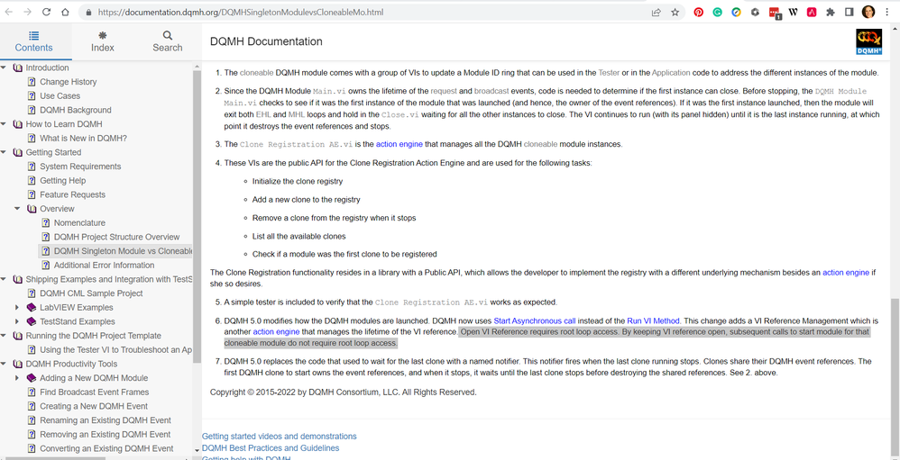

Since v5.0, the Start Module function for the Cloneable module has changed to prevent this issue:
  1. The reference to the main.vi is obtained at the first Start Module call and kept in memory until all started instances are stopped.
  2. The Start Asynchronous Call is used instead of the Run Vi Method
With that in mind, you can prevent the root loop issue by doing the following:
  • With a singleton module, you need to start it before showing the UI and avoid starting/stopping it during the application execution.
  • With a cloneable module, in case you want to start multiple instances during the application execution, you must start a dummy module at the beginning of the execution before showing the UI. All subsequent Start Module calls will work fine because the Open Vi Ref is not called anymore
The DQMH documentation mentions the issue (see the picture below) but deserves more details and actual use-case examples.
