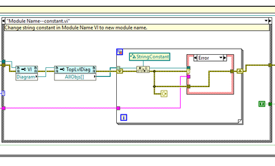

The screenshot above shows the problematic part of the Scripter - update module name in VIs.vi
Patchwork #1
Replace the shift register of the error cluster by a tunnel:
- If there is only one string contant on the BD of the module name VI then this works fine
- If there are more than one then it will change the content of the most recently placed constant
Patchwork #2:
one can have as many string constants on the BD if these steps are followed:
  1. after your modifications of the VI save it
  2. Delete the string constant having the module name with Ctrl-X
  3. Resave the VI
  4. Paste the constant back with Ctrl-V (plus wire it back to the output)
  5. Resave the VI
This puts the constant to the first place in the All OBJ array so the for loop above finds it at the first iteration.
These are not THE solution to the problem, but work as a hotfix until the problem is properly addressed.
Besides this another problem is that Save.Instrument VI is inside of the for loop (not show in the screenshot). This means that if prevous operations (Renaming labels in other VIs) finish successfully then their changes got saved so the labels will reflect the new module name while the renaming process ultimately fails rendering the labels and the module name to be inconsistent.
To address this below is another quick fix which at leasts doesnt save the VIs if an error occured. I dont consider this one as a solution either:
