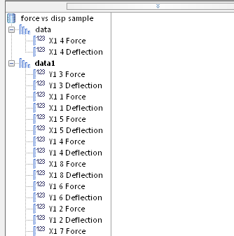

snips.PNGThis is how my data portal looks like.  The command works because I have the "data" group and the "X1 4 Froce" channel in that group.  If your data portal looks differently ("data1/X1 4 Force") then you either have to modify your code or your group/channel naming.  If you have a large set of channel groups, you'd need to use this setup in a loop to address each group.

Yea, Im thinking maybe I have it copied wrong?
I tired both groupings below. same out come.
Message 7 of 8
(3,976 Views)
Try [1]/X1 4 Force ?
Dim force: force = 5
Dim row: row = ChnFind("Ch([1]/X1 4 Force) > " & force & "", 0)
Call DataBlDel(Data.Root.ChannelGroups("data").Channels("X1 4 Deflection"), 1, row)
