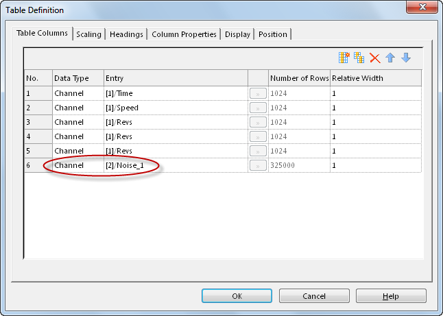

I try to do a table in the report programmatically with Diadem 9, but the problem is that I can not have more than 2 rows and 3 columns.

Here is code that adds an additional column to a channel. Basically, you have to open the table object, add the type and channel name and then close the table object.
Call GraphObjOpen("2DTable1")
  D2TabDataType(6) = "Channel"
  D2TabChnName(6)  = "[2]/Noise_1"
Call GraphObjClose("2DTable1")
In the above example, I edited the table called "2DTable1", added column number 6 as a channel that references the values from a channel called "Noise_1" from group number 2. See screen shot below:
