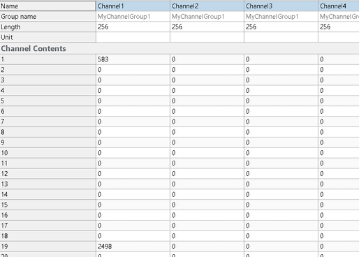

I followed an internal example given in Diadem help for binary files, which says read the files as blocks.
Here is the attached code .
Option Explicit
Sub ReadStore(File)
Dim Block : Set Block = File.GetBinaryBlock()
Dim ChannelGroup : Set ChannelGroup = Root.Channelgroups.Add("MyChannelGroup")
Dim Channel1 : Set Channel1 = Block.Channels.Add("Channel1", eI16)
Dim Channel2 : Set Channel2 = Block.Channels.Add("Channel2", eI16)
Dim Channel3 : Set Channel3 = Block.Channels.Add("Channel3", eI16)
Dim Channel4 : Set Channel4 = Block.Channels.Add("Channel4", eI16)
ChannelGroup.Channels.AddDirectAccessChannel(Channel1)
ChannelGroup.Channels.AddDirectAccessChannel(Channel2)
ChannelGroup.Channels.AddDirectAccessChannel(Channel3)
ChannelGroup.Channels.AddDirectAccessChannel(Channel4)
End Sub
Using above script is given in example: 3, and it does following
Using above example, I am able see the values, as per required format : i.e First 16 bytes to Channel 1( value 1), next 16 Bytes to channel 2 ( value 1) as given in the example.
Next Step - 1
Now , I am stuck at finding a code to create a particular number of channels in a loop ( for eg: 64 channels) as given in above code using
 and add those channels to File using following command.
Next Step - 2
Once , the given number of channels will be created, I have to make algorithms to convert binary value to in each channel with the corresponding Mathematical Algorithm.
Is there any way possible to store different mathematical algorithms ( for Eg: we have 64 channels, so 64 mathematical algortihms).
While the Step-1 script will be running , while assigning the values to channels , corresponding algoithm will be selected and applied to that channel from a data base of algortihms.
Next-3
As type of algorithms are fixed, For: Eg scale by 90 , left shift by 4 and then scale by 120 etc..
My next step would be to create a GUI , where user can select algorithms against each channel and then , when a binary file is loaded , it will be converted directly into readings and can be viewed on reports.
Thanks for your reply.
