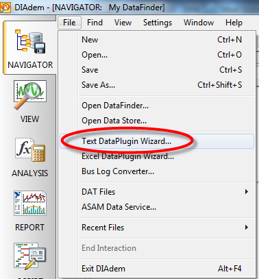

HI,
I have attached a .csv file which when openened in the diadem, first it shows only two channels whereas it actually contains 4 channels.
Secondly it opens with the channel names as noname, noname_1 whereas the channel names are on the top of the file. May I know the reason and solution for this problem.

Hello X. Ignatius,
Have you tried loading this file using the "Text DataPlugin Wizard" in the Navigator? I was successful with that approach on your file, the standard CSV file importer may get confused by something inside your file ...
I hope that helps,
      Otmar

Hi Igni,
I just created this DataPlugin for your submitted CSV file.

Hi Igni,
You didn't mention a DIAdem version, so I built it to work with DIAdem 2012, 2011, or 2010.  I missed by one version, since DIAdem 2010 released directly after DIAdem 11.1.  I've now recoded the DataPlugin should work with DIAdem 11.1 as well.

Hi Igni,
I have once again changed the USI version so that the DataPlugin will now work with all DIAdem versions later than DIAdem 9.1.
There is a DataPlugin API description and several examples in the Help system of DIAdem.
