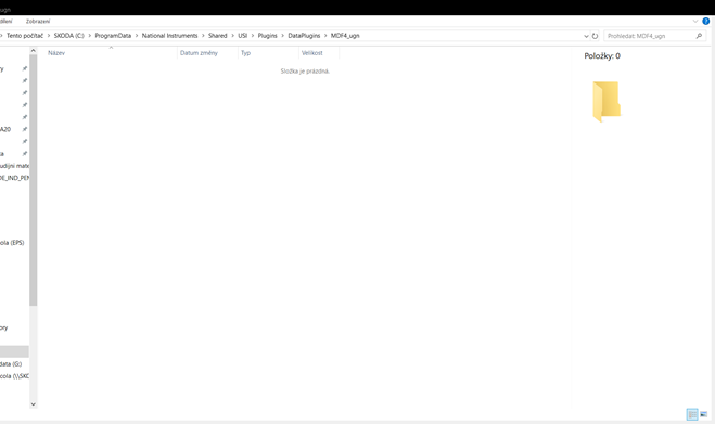

She registered the usi and tried to reinstall the plugin with the .exe file. the folder in "ProgramData" is empty and it tells her that "no software will be installed", but she wants to install it.

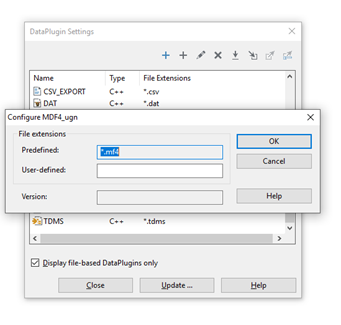

Screen of her and her colleague plugin detail:

her installer is missing the step to install it.
I think she doesnt have it installed properly(as seen on the first screen her version is missing), but we dont know how to force the install.

The install folder has changed to
"C:\Program Files (x86)\National Instruments\Shared\USI\DataPlugins\MDF4"
and
"C:\Program Files\National Instruments\Shared\USI\DataPlugins\MDF4"
the files should be installed here.
But the registration of the plugin failed on the machine. 😞
Could you please try to double click
"C:\Program Files (x86)\National Instruments\Shared\USI\DataPlugins\MDF4\uspMDF4.uri"
and check if this repairs the plugin.
If this does not work and the folders of the start exists please try the following:
  • Open the DataPlugin Dialog in DIAdem 2020
  • Import the uri file
    "C:\Program Files (x86)\National Instruments\Shared\USI\DataPlugins\MDF4\uspMDF4.uri"​
Did this help?
Questions:
  • Did the files exist at the new position?
  • Did double click the uri work?
  • If necessary: Did register with DIAdem work?
If you need to uninstall the plugin the NI Package manager is needed.
