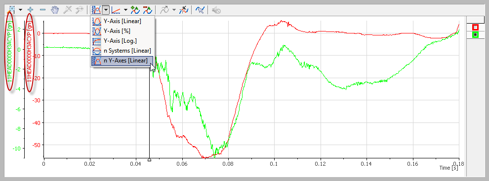

I am trying to plot two channels on the same graph.When I am dropping the first channel y axis is displaying the unit but when I drop the second it disappears.When I transfer to report also it is not coming.Do any body experienced this problem.how to solve it

This is expected behavior if you only have one Y-Axis in VIEW.
Have you tried selecting "n Y-Axes" in the settings for the graph? That gives you the result you would expect. With only one Y-axis, we cannot determine what unit you would prefer to see on the axis ...

Thanks a lot for you reply.
I also tried this .But after transferring to report I am able to do this ie. by labelling
