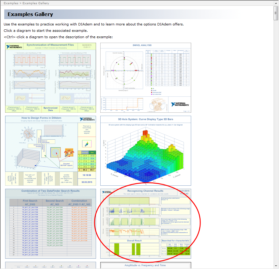

Hello EC,
DIAdem 2015 has introduced the Event Finder functionality in the ANALYSIS panel.
The example called "Event Search" in the examples gallery shows how the use that function:
If you hold CTRL while clicking on the example image you get to the files that make up the example:
The VBS (Visual Basic Script) file associated with this example shows how to use the "ChnEventFilter" feature of DIAdem to detect the duration of an event.
Please have a look at the example, check the VBS file for the code and I think you will find the answer to your questions.
Let us know how we can help further,
      Otmar

Hello EC,
The Event Finder is new in DIAdem 2014 and expanded in DIAdem 2015 (with the duration finding tool) - these functions are not available in earlier versions of DIAdem.
     Otmar
Otmar D. Foehner
(5,053 Views)
