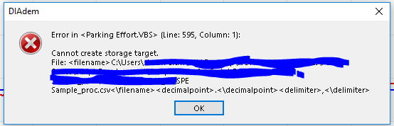

I have discovered some extra information about the problem - maybe it will help someone to solve it.
By accident I was reading about xml files and low and behold the file structure uses tagged markup of the form <filename> for start tags and </filename> for end tags. Perhaps it is xml that is being used in DIAdem scripts to modify the output of files saved using DataFileSaveSel??
I checked the error message that I was receiving and the log file and they both show that DIAdem is changing the forward slash in the end tag for a backward slash, and thus confusing it for a filename.
The logfile message is:
283 15:45:54 Error:
Error in <Parking Effort.VBS> (Line: 595, Column: 1):
Cannot create storage target.
File: <filename>C:\Users\blah_bah\SPE Sample_proc.csv<\filename><decimalpoint>.<\decimalpoint><delimiter>,<\delimiter>
The error message is the same:
But, the line of code in my script is:
T1 = "<filename>" & DataFileName & "</filename><decimalpoint>.</decimalpoint><delimiter>,</delimiter>"
 Note the change in slash direction in each end tag!
Is there some strange setting in DIAdem that I've missed when installing it on my new laptop?

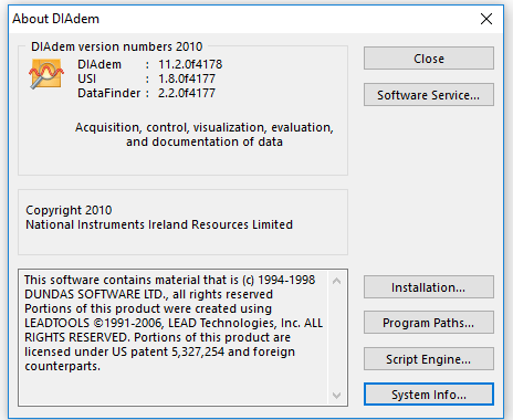

Hi Andreas,
Thanks for the response. Both machines had DIAdem installed from the same disc and should be identical installations. I don't have the old machine anymore so can't prove the version numbers, but here's what I have from the new machine:

The XML like string is an option to create user specific CSV files since a long time.
I am not sure when it was introduced but it is not related to the Operating system.
In your case your DIAdem does not realize the tags inside the string. It just assumes it is a path.
If excactly this script worked on your old machine the DIAdem versions is definitively different.
Is the script really identical?
In DIAdem 2018, we introduced the CSVExportParameter to allow an easier to understand way.
Message 7 of 9
(4,591 Views)

Option Explicit
dim selChns : selChns = "'[1]/[1]', '[1]/[2]'"
dim filePath : filePath = TmpDrv & "save_custom_csv.csv"
dim paramString : paramString = "<filename>" & replace(filePath, "&", "&amp;") & "</filename><decimalpoint>.</decimalpoint><delimiter>,</delimiter>"
Call DataFileSaveSel(paramString, "CSV", selChns)
works with DIAdem 2015 which is the oldest version I have.
If it does not work on yur machine and worked before, there has been a different version installed.
P.S.: If you path conatins an & this would also cause issues and needs to be escaped.
