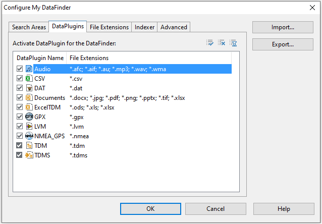

Hello JSal,
Can you please go to the following menu and call up the DataFinder - DataPlugin screen shown below:
You get there by selecting the "Settings > My DataFinder > Configure ..." item in the menu and then clicking on the "DataPlugins" tab.
Please check to see if the Matlab DataPlugin shows up in there and if it's activated (checkbox in front of the name is checked).
Feel free to post a screenshot so we can see what's available and go from there.

Yes, the MATLAB DataPlugin is present and checked.

Can you go to the next TAB in the same dialog called "File Extensions" and show us what's happening with *.MAT files in that dialog please (scroll down to the *.mat extension in the "index-able extensions" segment?
