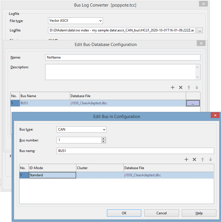

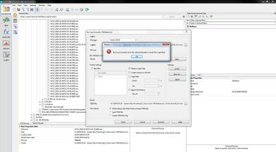

I have some difficulties with the bus log converter that I don't understand. I have files in ".asc" formats that I interpret with a standard J1939 ".dbc", I can't get any information, or I get error messages.
Because of this I am obliged to use another software. If someone has an idea?
Attached is a zip including: a dbc to open the raw asc file, and the final TDM file obtained through Ipmotion.

I am unable to read the IPmotion .TDM file 'HCLF_2020-10-01T16-01-09.TDM' you provided with DIAdem.  However, I was able to configure the DIAdem Bus Log Converter to read the file 'HCLF_2020-10-01T16-01-09.222Z.asc' along with the CAN database file 'j1939_ClaasAdapted.dbc'.   File 'HCLF_2020-10-01T16-01-09.222Z.asc' is a Vector ASCII (.asc) file. Below is an image of the contents of the Data Portal after a successful Bus Log Conversion.
Below are images of the configuration of the DIAdem Bus Log Coverter:
I also included a file named 'ascii_CAN_bus.zip' with a script to programmatically perform the bus log conversion (on multiple files).

I can see from the DIAdem LogFile that many messages were not converted.  This could be because I don't have the "complementary dbc".  Could you please send me that file so I can try the conversion again?   markwkiehl@gmail.com

The two additional CAN database (.dbc) files are what was needed.  Modifying the script I gave you to include them resulted in a total of 12 channel groups, and a total of 68 channels.
So now you can use DIAdem to decode those CAN bus Vector .asc log files.

the result is more complete with the other dbc, but that wasn't the problem. The problem is that there are many more measurement channels around the engine, and the Diadem log converter bus only sees 3 messages: Sequence,TotalVehicleDistance,TripDistance and that ipemotion .
Below is an image of the engine measurement channels open in Diadem converted by ipemotion.
and an .asc file converted by ipmotion with only the dbc "classadapted" engine.
