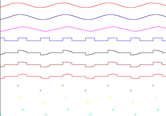

Let me restate the problem....
When you encounter the first min/max, then you want to search for a min/max on the other two channels, within 100 samples or so. Correct?
If I simulate it, it looks like this, where the last three channels are the min/max value, at their correct time stamps. I used the Min/Max TTL and the Sample trigger module to define an area of 100 samples, then used the Relay to replace all values out of the area with zero. The resultant signal may be what you want to do the next two min/max values in.
Now.... what timestamp do you want on them? The first, the second, the third?

Ah, that's a neat way to go about it.  I want the timestamp from the first channel.

Accepted by qzerror
Here's an example with a Generator.
Use the *.DSA file to open in V9. I'm not 100 certain that it will retain all of the settings, but it's a good start. The *.DSB file is DASYLab 12.
