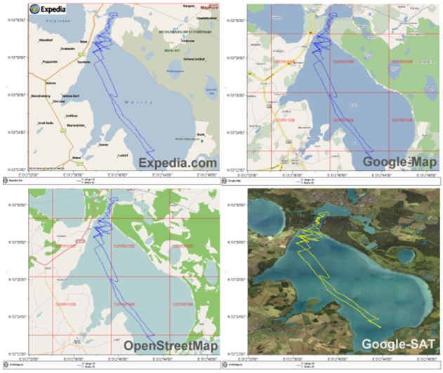

data? GPS is not usable for time informations, correct? But the coordinates are usable for X/Y plot? What you needs is a Moving Map?
Moving Map is a visualization option to display maps in a line chart. GPS values (measured values of imports or GPS receiver) define the location to be displayed. The maps are downloaded from the map provider of your choice (currently supported: Expedia, Google and OpenStreetMap).
Now you can create demonstrative and impressive visualizations of maps combined with measured data e.g. from trial runs.
Is this what you needs?
