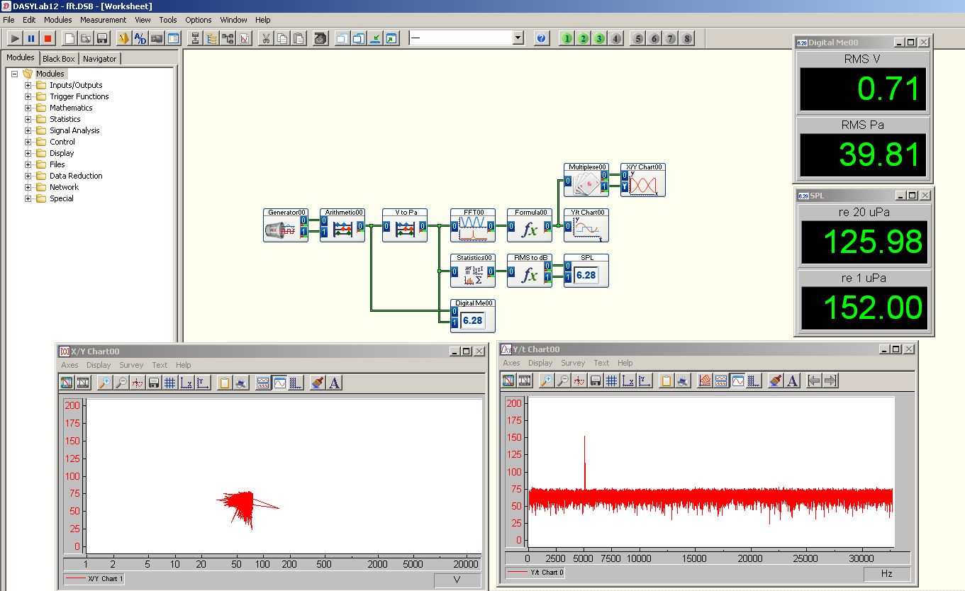

I'm trying to get my fft to display the frequency (x-axis) with a logarithmic scale.
There is no option for this in the y/t chart
The xy chart has ths option, but i can't 'demultiplex' the fft output signal sucessfully.
I'm using DasyLab 12.
Does anyone have any ideas?
Matt

Use the Time Base module (Special) to extract the X-Axis off of the FFT block.

Brilliant, Thankyou very much!
