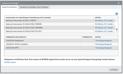

The system recognises the cDAQ Modules, but want me to install the actual NIDAQmx 20.1.
I have allready reinstalled and removed NiDAQmx 2 times but no success
I also removed and reinstalled DAQExpress.
The MAX is also actual.
If I want to connect to the remaining cDAQ-Modules i get the following error message:
Harware is possible connected to an other system.
 (that is not true, as it worked with Labview in just thjat actual system)
whlie connecting it I get a lot off error messages.

I haven't faced this issue but have you tried to repair those drivers using NI Package Manager?
How did you delete them?

Yes I did it all via NI Package Manager.
My fault is, that I did not recognize that DAQExpress does not work with network cDAQ.
Makes it pretty useless for me, cause nearly all my cDAQ are connected to the LAN-Network.
