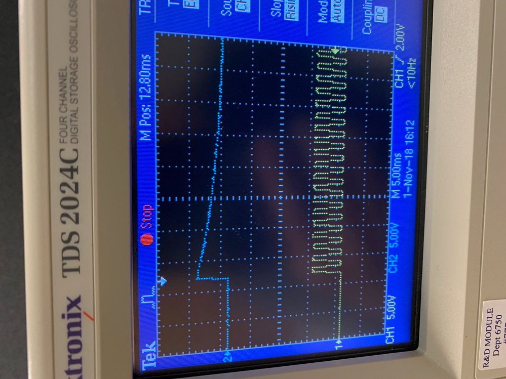

    I am using a NI 6030e connected to SCB-68.
    And use CTR1 out and CTR0 out to generate pulse train to control step motor.
    But I found that if CTR1 or CTR0 is generating pulse train, at the beginning of the pulse, the other channel will have a voltage rise too as shown in the image.
     any way to solve this issue?

You're probably running a Finite Sampling pulse generatoin task.  In the E-series generation of counters, both counters work together to accomplish a finite pulse train.  One generates pulses only while the other one is in high state, that's the mechanism to control the finite # pulses.
This behavior changed with the introduction of X-series boards (PCIe-63xx).  On those, finite pulse trains only use up 1 counter.
There's a little more complicated way to configure the 2 counters manually to accomplish a finite pulse train while suppressing or redirecting the output of the one that generates a single long pules to control the other.   You can start by reading this.

1. Your DAQ board has 2 counters.  Both *MUST* be used to generate a single pulse train with a known # steps.
2. Therefore, you *CANNOT* run 2 finite pulse trains out to 2 different stepper motors at the same time.  Your DAQ board simply isn't capable.
3. However you *CAN* run finite pulse trains out to 2 different stepper motors at *different* times.  You would use the technique I showed in the link, but exchange the roles played by ctr0 and ctr1.  The main purpose of that technique is to suppress the output signal from the "helper counter" so it won't send a single step pulse to the stepper you aren't trying to operate.
4. Reiterating, if you need to operate the motors *simultaneously*, there really isn't a good counter-based solution with your DAQ board.  You *might* be able to do such a thing with an AO task, but it will be much less straightforward to define step pulse timing.

   I tried the method in the other thread, but looks like even I set the CO.Pulse.Term = " ", I still can get the pulse output from the counter output. is it normal?

    Thanks for the quick reply.
    I am using python to control the DAQ, not sure if you can help on that. here is the code.
outputchannel = "Dev1/Ctr0"
gatechannel = "Dev1/Ctr1"
frequency = 1000
samples = 1000
def GenerateFinitePulse(outputchannel, gatechannel, pulsecount, frequency):
    with nidaqmx.Task() as pulse_task:
        pulsechannel = pulse_task.co_channels.add_co_pulse_chan_freq(
            counter=outputchannel,freq=frequency, duty_cycle=0.5)
        pulse_task.timing.cfg_implicit_timing(
            sample_mode=nidaqmx.constants.AcquisitionType.CONTINUOUS,
            samps_per_chan=1000)
        pulse_task.triggers.pause_trigger.trig_type = nidaqmx.constants.TriggerType.DIGITAL_LEVEL
        pulse_task.triggers.pause_trigger.dig_lvl_src=gatechannel + "InternalOutput"
        pulse_task.triggers.pause_trigger.dig_lvl_when = nidaqmx.constants.Level.LOW
        pulse_task.start()
        with nidaqmx.Task() as gate_task:
            gatechannel = gate_task.co_channels.add_co_pulse_chan_time(
                counter=gatechannel, low_time= 1, high_time= pulsecount/frequency)
            gatechannel.co_pulse_term = " "
            gate_task.start()
and somehow it also can't find the "Dev1/Ctr1InternalOutput".
Thanks!

after adding "/", now there is no error from the code.
but through oscilloscope, I still can detect pulse from both channels, after I use empty string "".
and the pulse read from oscilloscope is strange.
from the output channel, it became a long pulse instead of a number of pulses. and from the gate channel, I can see one short pulse which suppose to be a long pulse.
