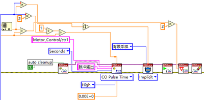

Thanks Kevin.
This might not be the rollover effect. I can generate the pulse train of the same finite number in same time consumption using LabView VIs like this.
This is mainly caused by the inaccurate clock signal or pulse frequency when I use MATLAB to control the card. (This also may caused by my wrong used code)
For example, I want to generate 10000 pulse in about 2 second, in LabView, I set 'Sample per channel' to 10000 and the  ' low Time' & ' high Time' to 1e-4. This program give me just the number of pulse and the time consumption I expect. In MATLAB, I set the Frequency (pulse per second) to 5000 and the time duration to 2s, but it gives wrong output pulse number. (The LabView code indicated the card had the ability to achieve this)
In fact, I focus mainly on the Number of pulse rather than the time duration (I need exactly 10000 pulse and the time of 2s is not such necessary). I want a method that I could directly control the number of the pulse in MATLAB rather use the product of time and pulse frequency.
I think this can be also achieves by MATLAB, but I didn't find any solution yet. Thank You Anyway.

Does your Matlab code produce slightly different total #'s of pulses on different runs?   If so, it sounds like the config you've used is measuring the 60 sec duration in software somehow, then reacting with a software command to stop what was otherwise a continuous pulse train.
Take note of the fact that your LabVIEW config had to set up several distinct parameters and properties that are not accounted for in the Matlab code.  Particularly, nothing similar to your call to DAQmx Timing where you can choose Finite Samples (rather than Continuous), while explicitly setting the # samples to generate (and have that # controlled at  the hardware level).
Dig a little deeper in the Matlab API, I expect there are functions to let you do the config you're after.  I just don't have any idea what they're called or where to find them.
