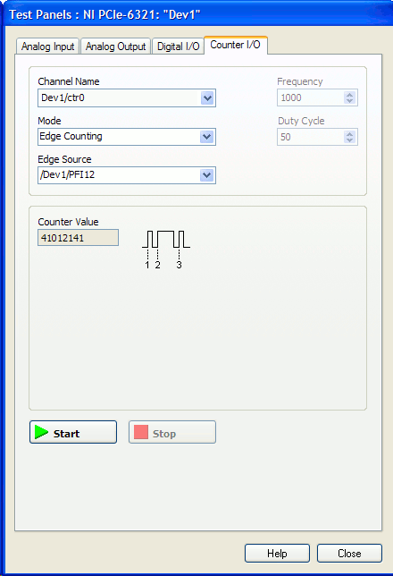

I generate 20 ns pulses with my pulse generator and count them using this test panel:
From 0 to 59 us between pulses, all pulses are counted. From 60 us onward, no pulses are counted.  If I look at the pulse height with an oscilloscope (Oscilloscope <-> External digital pulse generator >> BNC Cable >> BNC-2110 >> SHC-68-68-EPM >> 6321 (counter input)), all the pulses look high enough to be counted (5V); additionally, the pulse height does not change with pulse repetition rate.  Therefore, something is happening further down the line between the pulse generator and the 6321. Unfortunately, I cannot connect my oscilloscope further down the line to see what is going on. Therefore, I ran the following  tests:

6321 (generate pulses) >> SHC-68-68-EPM >> BNC-2110 >> BNC Cable >> BNC-2110 >> SHC-68-68-EPM >> 6321 (count pulses)
I used the following VI:
I set the "high time" to 20 ns. Pulses are counted for "low time" less than 115 us, and not counted for "low time" greater than 117 us.  Note this is roughly double the minimum low time for a pulse to be counted after 1 pass through the BNC-2110; I suspect this is because the pulse makes two passes through the BNC-2110. Since I had a hunch that it doesn't matter whether the pulse is going into or out of the BNC-2110 for this behavior to occur, I did a fourth test:

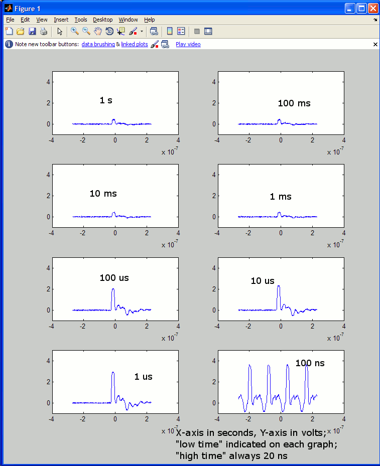

Test 4:
6321 (generate pulses) >> SHC-68-68-EPM >> BNC-2110 >> BNC Cable >> Oscilloscope
The high time is again set to 20 ns. As I decrease the low time, note that the pulse height increases. As low time goes from 60 us to 59 us, I have verified that this is the point at which pulse height increases above 2.2 V, crossing the TTL detection threshold of the counter (as consistent with the threshold observed in Test 1).
Does this help clarify the issue, and relate it to the last series of screenshots I posted (with 50% duty cycle pulses, generated on the DAQ and viewed on the oscilloscope)? Note that pulse height does not change until "low time" is decreased below at least 1 ms.

An additional test I performed, similar to Test 3 from the previous post:
6321 (generate pulses) >> SHC-68-68-EPM >> 6321 (counter input)
I jumpered together PFI12 and PFI14 at the end of the cable to form the loopback.  With this method, the upper limit of the pulse "low time" that is detectable is now 182 us (it was previously ~115 us). Therefore, part of the problem is occurring in the cable, and part of the problem is occurring in the BNC-2110. Note changing the length of the cable has not caused my results to vary in the past.
