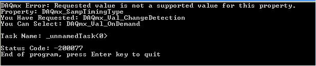

I found this example in nidaqmx example directory (Read Dig Chan-Change Detection Event)
Iit compiles , but it doesn't work..... i have this error
WHY ? What does it mean ?
Here is the entire code, in red (the wich generates the error).

Hi blacksocket,
The error you are getting indicates that the hardware does not support your settings.  In this case, the 6602 does not support change detection (here is a list of hardware that does support this feature).  Let's use your other thread to look into possible alternatives.
