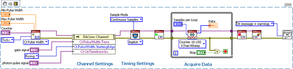

   There's another way to get the measurement you want while using just 1 counter.   You would perform a pulse-width measurement using units=Ticks.  The photon pulses would be used as the timebase while your gate signal would be considered the thing to measure.  Below is a snippet to illustrate based on slightly modifying a shipping example.
When I tried it on a simulated 6733, I tried to also set up duplicate count prevention and got an error that the property isn't supported.  Consequently, I can't tell you for sure what will happen in a scenario where no timebase (photon signal) edges occur during the high time of a gate pulse.  I have a vague recollection that it may either give you a repetition of the previous value or it may simply fail to buffer a measurement.  The "correct" behavior would be to buffer a 0 value, and that's why the idea of the confusingly-named "duplicate count prevention" property came into existence.

Oops, after mentioning an *intention* to attach a snippet, I kept writing more stuff & forgot.  Here it is for real this time.  (I now notice I also should have changed the type of the 'Data' array in the loop to U32.)
