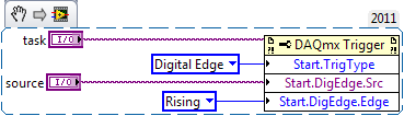

>> do you know what property i need to set in order for the outputs to wait for a trigger?
Properties of the class DAQmx trigger are
Start -> Trigger type: Digital Edge
Start -> DigitalEdge -> Source
Start -> DigitalEdge -> Edge (do not need to set it, default = rising)
I do not know how to get to this class  in Matlab. LabVIEW code does not have any function like SetTrigger (similar to addCounterOutputChannel) that gives you this class output.
It looks like it is derivative class from session (session is called task in LabVIEW) not from the channel.
I would say you need 2 different sessions (I have 2 separate tasks in LabVIEW). First - ctr0, no trigger. Second - ctr2 and 3 - start trigger. Then you first start session 2, then session 1: session ctr2, ctr3 should be already running and waiting for the trigger when you start session 1 (immediately sends trigger).
