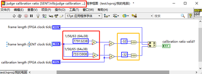

First of all, I will give my warm appreciate thanks for you work that develop this API. The API has worked, according the SENT protocol 2010, I have understood the most of your API program. But I still have two doubts about the API.
1.In the "judge calibration length.vi", what's the right shift 2^22 used for? I can't find any data that described in the SENT-2010 protocol which corresponding 22 bit.
2.This doubts is the same with the fisrt one. In the "judge calibration ratio.vi", where those two data "77913238" and "75515908" come from in the red rectangle? And where the 32 bit right shift come from the SENT-2010 protocol?
Thanks again for your hard work on this API.
