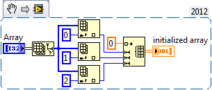

Well look at that! So... Are you saying I don't get to do this anymore 🙂 ?
EDIT: P.S. my first snippet, a good one

@vekkuli wrote:
@altenbach wrote:
Figuring out that "index array" is resizable... wait, In LabVIEW 4.0 it actually wasn't! 😄
Even a resized "index array" would be overkill. Here's equivalent code. 😄
Message 9 of 18
(9,893 Views)
@altenbach wrote:Even a resized "index array" would be overkill. Here's equivalent code. 😄
Of course if the input array is in a floating point representation, you need to be very careful. It will not work the same if the input array has elements that are NaN, Inf, or -Inf. They would turn into NaN in the output array instead of zeroes. With an integer input as in the above case, there is no such problem.
