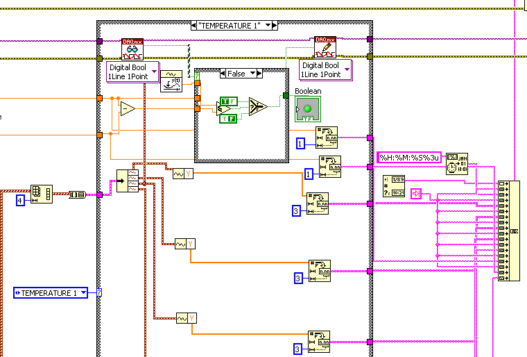

I found some very nice little Rubes today, here...
First of all, anyone want to guess why we're taking a 1D array (the output of DAQmx Read, N chan N samp, 1D waveform) and resizing it to a....1D array???
Then, we decide we'd better turn it into a cluster, then unbundle it...
...then we take all of our separate data arrays and format them into strings...
...then concatenate the strings.
Now let's look at that case structure.  It's the ever popular use-a-boolean-to-select-the-same-boolean-value-contained-in-the-original-wire trick!  The "true" case does the same thing, but uses a different number for the "greater or equal" comparison.
Now, we could have written it like this:
But that isn't very much fun.
We also could, perhaps, have used the "2D DBL" instance of DAQmx Read, and skipped all the get-the-data-arrays-out-of-the-waveforms operations, but it looks like he uses at least one of those waveforms for something else so maybe he does need them.
