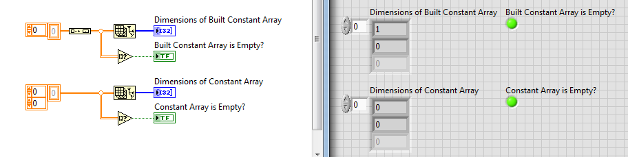

Thanks to Chris Roebuck for finding the following weird behavior.
It's possible to have an "empty" array that's not "really empty". Take the following snippet:
As expected, both arrays return a TRUE for the "Empty Array?" primitive, yet the first one returns a non-zero array for the dimensions:
EmptyArrayIsntEmpty
If you're not aware of this behavior, it could lead to unexpected results, when, for instance, autoindexing the arrays:

This looks like a candidate for the CLAD exam.

I hope not! I would never pass to become a CLAD! And thanks to altenbach for pointing me to this thread that further discusses the topic.
