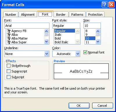

Amen to that - few things drive me more crazy than a teensy-weensy little non-resizable dialog box full of information.  Microsoft is great at this:
~80 fonts in one tiny little box
Look at the size of the scroll bar slider!!!
