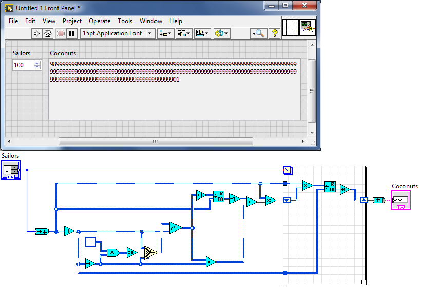

Just using altenbach's code as a test point for my math library....
I didn't count all of the 9's but it looks right to my eye.  For 1000 sailors there are just a bunch more 9's in the middle.
Message 18 of 53

@Darin.K wrote:
Just using altenbach's code as a test point for my math library.....
Cool! You should use the code in the FALSE case instead....(algorithm)
(However, since the world harvest of coconuts is limited (1.44kg/nut, 62 millions tonnes/year), we will run out of coconuts much faster than we run out of sailors (or monkeys) :D. Then there is also the limiting factor of transporting and hiding coconuts in a single night.)
And yes, you even caught the duplicate effort of subtracting 1 from a number. (I assume the compiler will at least take it out of the FOR loop (loop invariant code elimination) but we still do it once too many. :D. It would be more hurful in your code...)
Oh, and wow, such a library would be great addition to LabVIEW!!! How complete is it?
The integer part of the library is fairly complete, to the point I need to break up the class into separate libraries.  I have most of the basic operations covered, along with comparisons and bitwise operations.  A lot of number theory as well (prime testing GCD, modular exponentiation and the like).
Mine is written in pure G because I am funny that way, but if this were to be built in I would probably put the guts 'under the hood' and leverage GMP.  I agree that arbitrary precision math as a first-class citizen would be awesome.  I like how ints in Python do their integery thing with no worries about overflow and such unless you deliberately bind them to a fixed representation.
