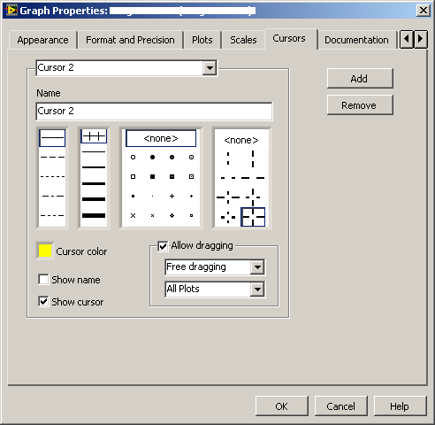

I have an existing graphs which has 3 cursors.  Works great.  Been running tests for a while.
I need to add one more cursor to the existing graphs.  As soon as I add a new cursor and set it's properties, I get a nasty error message and without warning LV8.2 simply closes itself.  Tried it 3 times, same result.
Shut down the PC, went for a coffee, rebooted the PC.  Opened the LV project, opened the VI.  Immediately went to the graph properties to add the new cursor by doing the following steps:
Right click graph indicator icon on block diagram.
Select Properties.
Click on cursor tab.
Click on Add
Select Cursor 2 (3rd one, newly created)
Change color
Select cursor as a line
Remove checkmark for "show cursor"
Click OK
I need to do this to 3 other graphs, same steps.  And as soon as I get to the step before clicking OK, I get the error message.
I now managed to get one done, and immediately saving.  But I've had this problem before when creating the first two cursors.
Is it a bug?  Anyone else seen this?  Using LV8.2.
And the message is right about LOOSING ALL unsaved work!!!!  😠

Additional notes:
Tried creating a new one on the second graph.
As soon as I clicked on the color, it crashed!

More additional notes:
I observed the title bar after making changes to the properties.  (Yes, finally, after a # of reboots, it's done)..
I noticed that 3 out of 4 times, while changing the properties of the graphs to include the cursor, and saving after each & every step, that there were no stars appearing on the title bar to indicate "unsaved changes".  Saving was also slower than usual.  I suspect, the program never got to placing the star before saving occurred.  However, I am noting everything.
AFter creating the cursors, saving is normal, and the program runs well..
