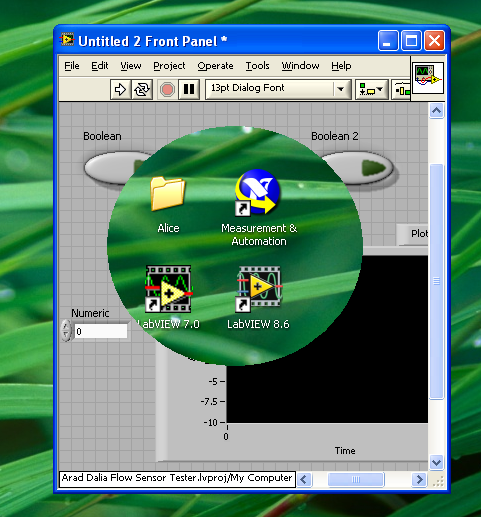

altenbach wrote:
(Now, how would you punch a hole all the way to the computer desktop? 🐵
Like this,
but it doesn't satisfy CC's requirement, as it uses the Windows API.

For those wondering, the Windows API function used to cut a hole in the window can be seen here. One of its parameters is a color input (I believe in that example that color is a constant) and when you use a color and make the panel opaque, everything of that color in the window becomes completely transparent. You can even click through it to whatever's below the window.
You should note that the VI posted there was just a quick example. It needs work and cleaning up.
