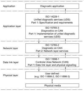

For UDS, we also use can bus for communication, right ?
Then what is the general steps for UDS by labview ?
Step 1: for hardware, we can use USB 8502;
Step 2: we use Xnet or something else ?
Thanks.
Learning from other people
(5,033 Views)
Reference: What is UDS Protocol | Unified Diagnostic Service in Automotive
USB-8502 provides the physical layer communication.
NI-XNET driver provides data link layer, on how the bits are encoded and decoded into CAN frames.
NI-ADCS provides the layers of network layer and above.
So the dependencies are: you use NI-XNET to control USB-8502 for low level CAN communication. NI-ADCS encapsulates NI-XNET API to do UDS communication.

So NI-ADCS support UDS and XCP, right ?
UDS for diagnostic and XCP for measurement/calibration.
Thanks.
(4,977 Views)
You need NI-ADCS for UDS and NI-ECUMC for XCP.
